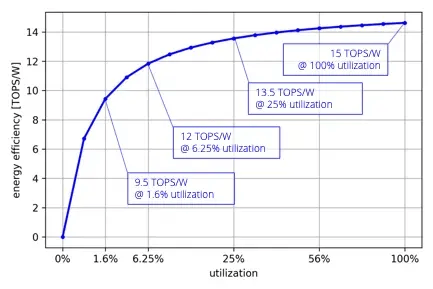

The D-IMC engine of the matrix-vector-multiplier is a handcrafted full-custom design that interleaves the weight storage and the compute units in an extremely dense fashion. Besides saving energy by not moving weights, energy consumption is further reduced by a custom adder with minimized interconnect parasitics, with balanced delay paths to avoid energy-consuming glitches, and with judicious pipelining to provide high compute throughput at low supply voltage. Although the matrix-vector-multiplier supports a large matrix size, by using both activity and clock gating, energy efficiency stays high even at low utilization. Note that the matrix coefficients can be written to the D-IMC engine in the background without stalling the computations.
