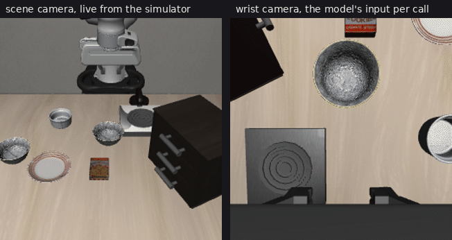

As a result, GR00T N1.7, a 3-billion-parameter vision-language-action model (VLA), now runs on a single Axelera AI Europa card with no accuracy loss versus the PyTorch reference, driving a simulated Panda arm through LIBERO tasks. I ported it and brought it to about 200 ms per decision (5 Hz), with every transformer in the model on the card. I am a product person, not an ML engineer: I did it by steering AI coding agents against AxScript, in about a week of part-time work (prompting the agent every 4-5 hours, between meetings or before going to bed) and around $500 in tokens, the same week Europa started shipping to customers. Then one of our engineers spent a day on it and took it to 66 ms (15 Hz), with the whole network, action head included, on the card.
This post is an account of how that went, what closed the gap between 200 and 66 ms, and what it says about AxScript and Europa for Physical AI.

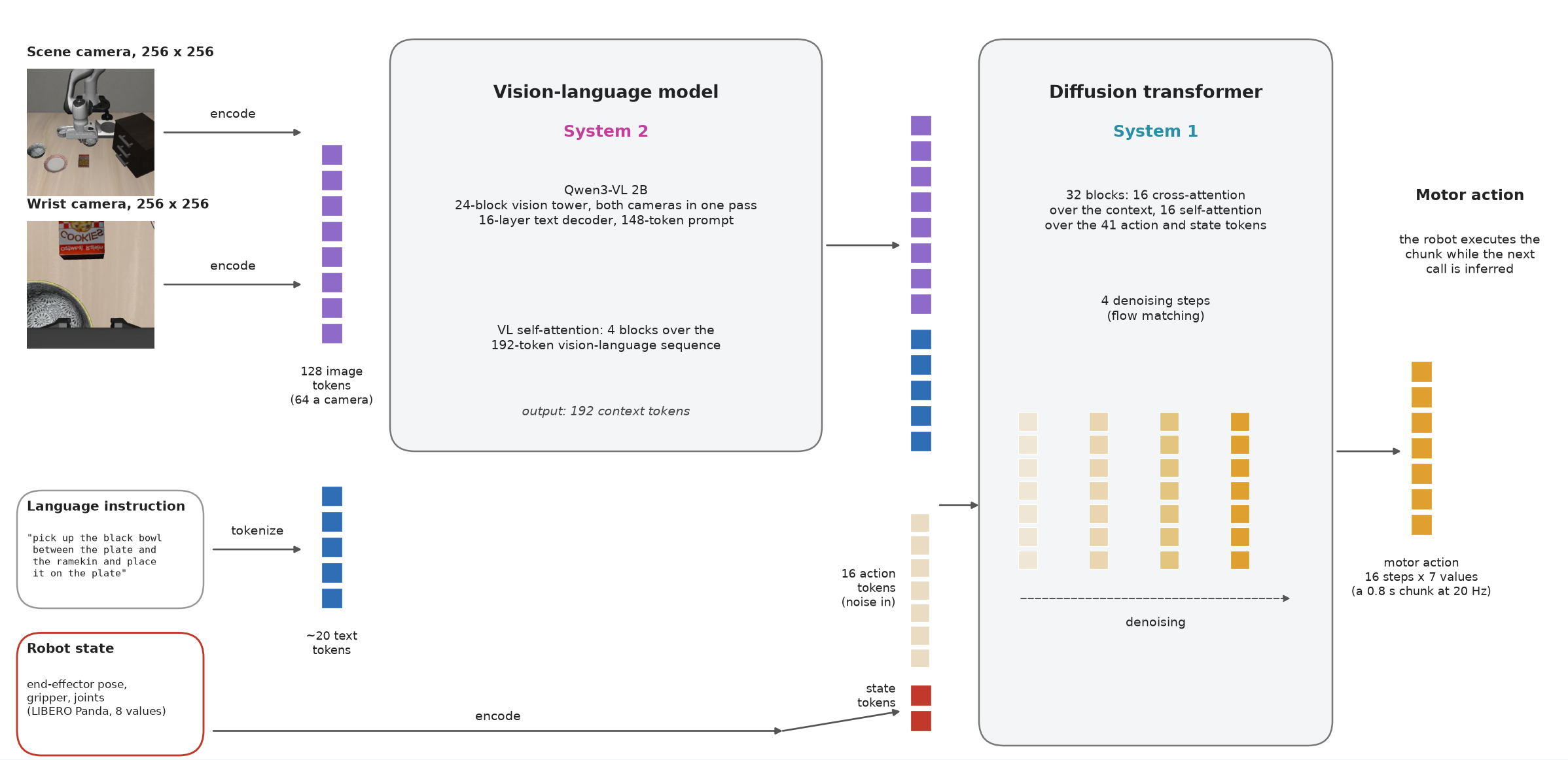

GR00T N1.7 is two models glued together. A Qwen3-VL vision-language backbone (a 24-block vision transformer plus 16 decoder layers) reads two camera images and the instruction. A 32-block diffusion transformer (the "action head") then denoises a chunk of 16 future robot actions in four flow-matching steps, attending to the backbone's output at every block. It is exactly the shape of model that generative AI at the edge is converging on: billions of weights, a transformer that runs many times per decision, and a hard real-time budget, because a robot that thinks for a second drops the bowl.

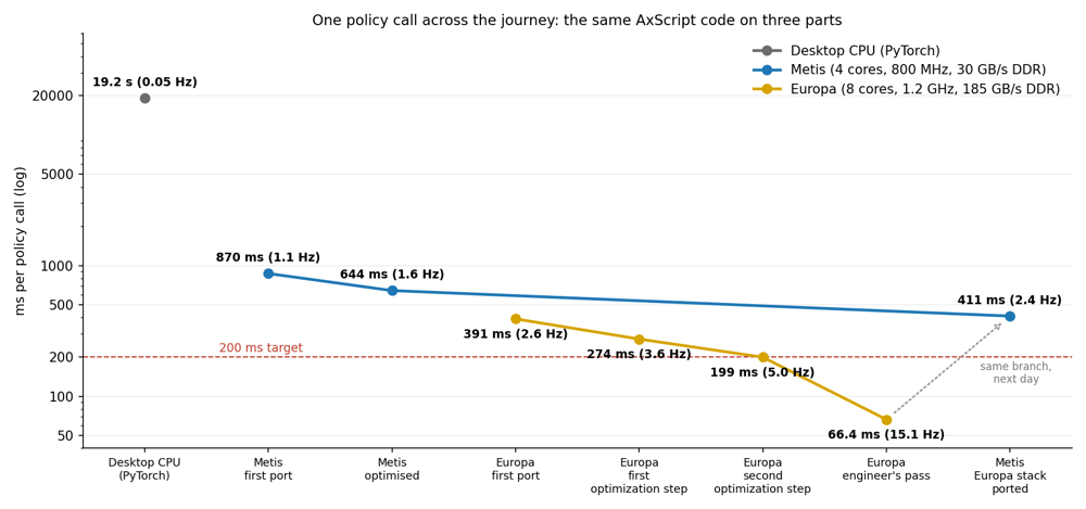

On the desktop CPU of the test host (an Intel Core i5-13500E), one decision took 19.2 seconds. The first port to Metis took it below 1s. Then I set out to bring it below 200 ms. When I was done, I asked for help and it went down to 66ms. Here is the full account.

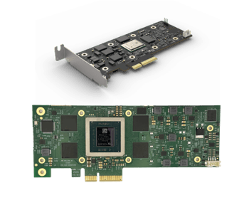

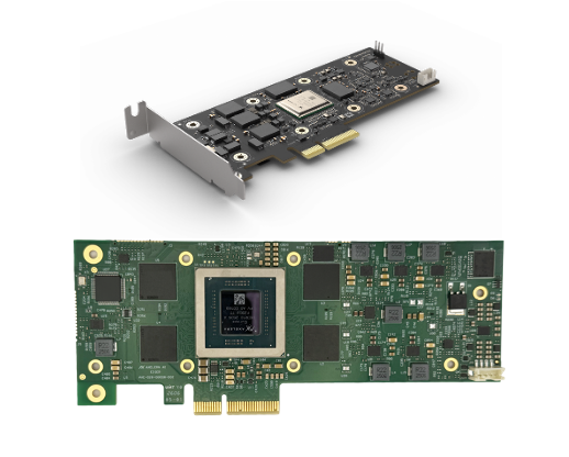

The Metis-based Axelera 130p (top) and the Europa-based Axelera 232p (bottom) cards used to run the VLA. Both are HHHL (Half-length, half-height) x4 PCIe cards.

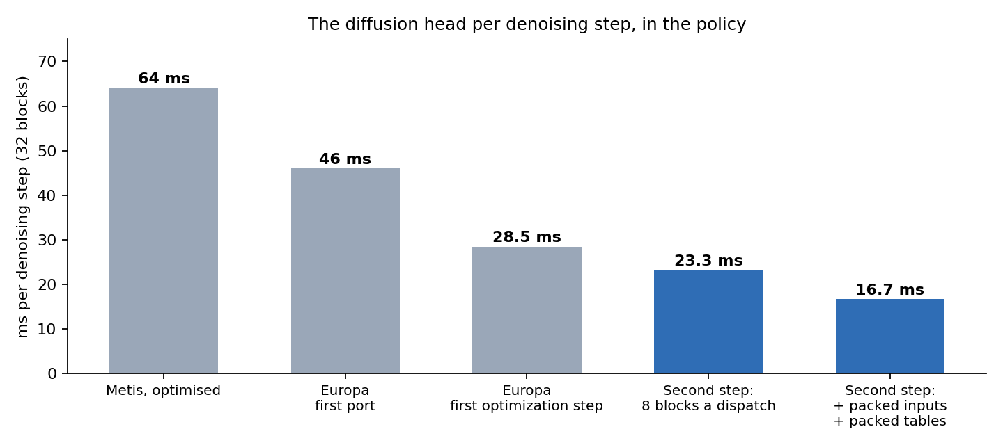

The second phase felt most like product management: provide the documentation (the AxScript performance guidelines), set a metric, insist on an A/B judge, refuse changes that cannot be measured.
AxScript exposes two levels of control in Python, and the agents used both. Schedule-level knobs on the SDK's matmul op: pipelining each tile's weights under the previous tile's compute, prefetching the first tile under the attention, sharding the big feed-forward across the four cores. And graph-level structure: the cross-attention blocks' keys and values are projections of the vision-language context, which does not change across the four denoising steps, so a "prime" graph projects them once per call into device state and the denoising graph reads them.
The head went from 86.8 to 64.0 ms per step, a 26% gain from documented knobs with no compiler changes. The call went from 870 to 644 ms, without impact to task success rates. But Metis was just my starting point, my end goal was always Europa and now I had a board. For context, Metis has 30 GB/s of LPDDR4X memory bandwidth; Europa has 200 GB/s.

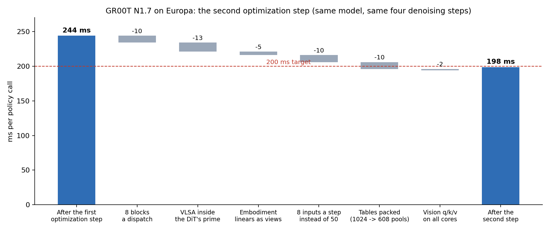

First optimization step. Using a newer, soon-to-be-released compiler, the decoder was compiled for the context length the task actually uses, each block's weights were split across the card's two memory regions so both stream at once, and the two cameras went through the vision tower in one dispatch instead of two. The call came to 274 ms, at the same accuracy.
Second optimization step. The remaining time was in the plumbing between kernels, and AxScript's graph descriptor already had the tools to remove it. The diffusion head went from 33 kernel dispatches per step to four by binding eight blocks to one call, a configuration change rather than new code. Folding the vision-language self-attention into the diffusion head's priming kernel removed one loaded model and one model switch per call. And trimming graph inputs (a denoise step went from fifty inputs to eight, and each block's eighteen small scale tables became three buffers) cut the runtime's per-run overhead. The head went from 114 to 67 ms for four steps.

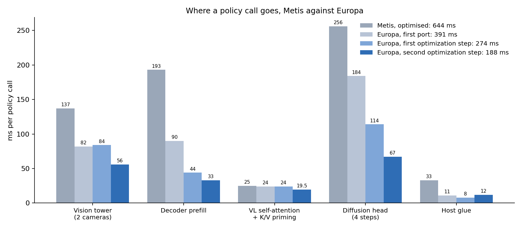

Per policy call
Metis, optimized
Europa, first port
Europa, first optimization step
Europa, second optimization step
Vision tower, both cameras
137 ms
82 ms
84 ms
56 ms
Decoder prefill
193 ms
90 ms
44 ms
33 ms
VL self-attention + K/V priming
25 ms
24 ms
24 ms
19.5 ms
Diffusion head, four steps
256 ms
184 ms
114 ms
67 ms
Policy call, steady state
644 ms
391 ms
274 ms
199 ms
LIBERO Task success
20/20
20/20
20/20
20/20
Action cosine vs PyTorch
0.9996
0.9996
0.9996
0.9965
Against optimized Metis, Europa's final numbers are close to 6x on decoder prefill (193 to 33 ms), almost 4x on the diffusion head (256 to 67 ms), and 3.2x on the full call. Against the host CPU we started from, the policy call is 96x faster. The small drop in action cosine in the last column (0.9996 to 0.9965) comes from the shorter compiled context and had no effect on the closed loop, which stayed at 20 of 20.
Hide the latency that is left. Even at 200 ms a call, a synchronous loop is visible: the arm executes eight steps, then holds while the next chunk is inferred. The fix was not in the model's speed but in the loop, and the model already carried it. GR00T N1.7's action head implements real-time chunking: given the chunk that is still executing, it denoises the next one so that the steps that will have run by the time it arrives are kept, the next few ramp over, and the rest are free. So the simulator now asks for chunk n+1 eight steps into chunk n, from a worker thread, keeps executing chunk n meanwhile, and splices the new chunk in at the index that corresponds to "now" when it lands, two to four steps later. Because the model was told which steps would already have run, the splice causes no jump in the motion. The animation at the top of this post shows this asynchronous loop
A second pair of hands: from 199 ms to 66.4 ms

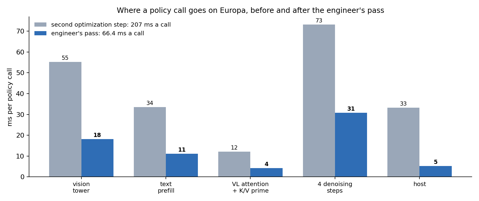

Under 200 ms was the goal, and the agents had reached it. With the documented knobs exhausted, their own estimate of the floor was around 170 ms. But I had a feeling Europa could do better. So I shared the port with Fabian, from our engineering team, to see how far he could push it, with the same model, the same two cameras, the same four denoising steps, and the same checks.

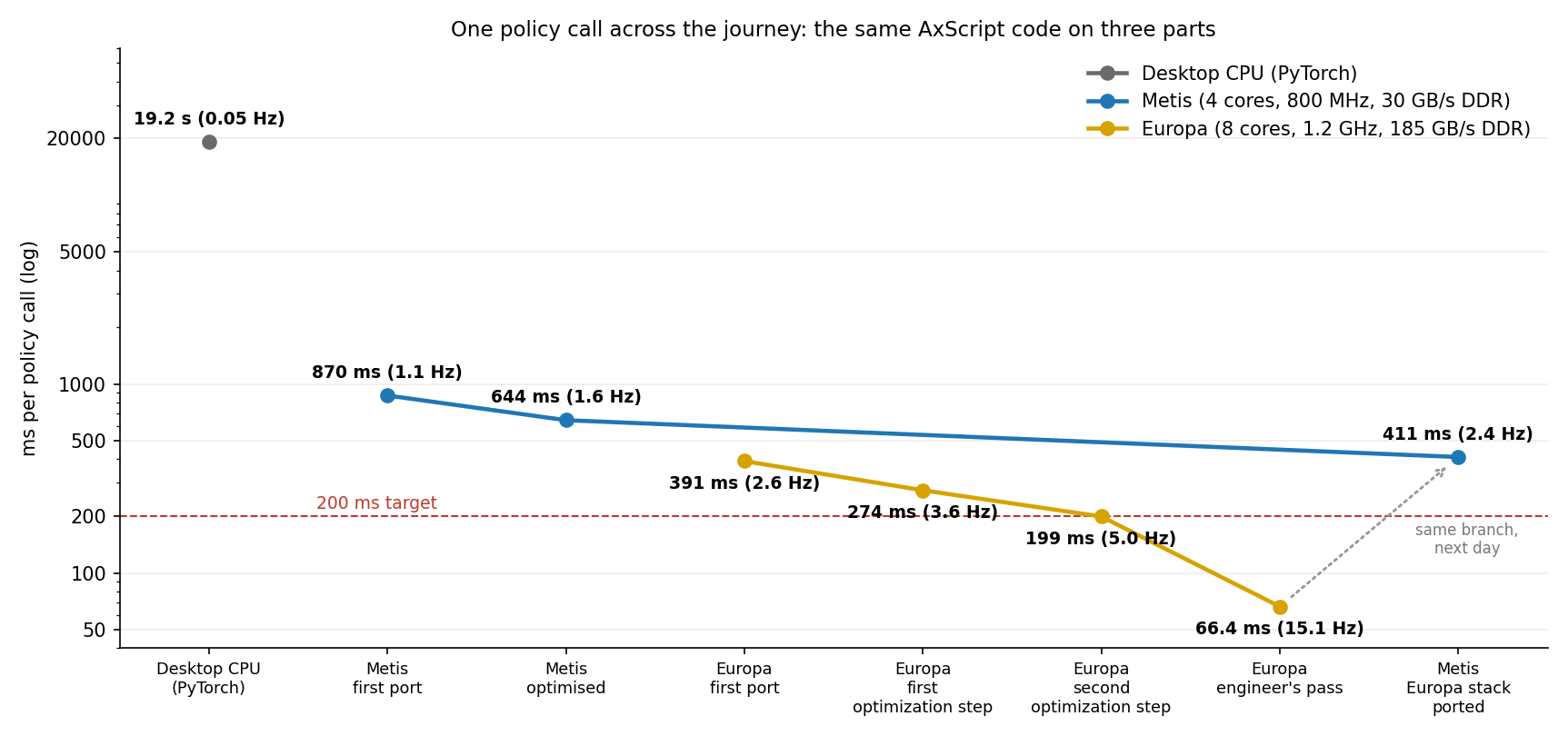

Less than a day later, one policy call went down to 66.4 ms (15Hz), 3 times faster than where I had left it.
image-20261010-213520
Measured with the host CPU kept out of deep sleep states between device calls, a one-line host setting that saves about 6 ms a cal
Every stage moved. The vision tower and the text prefill were re-cut so that all eight cores stay busy and every weight is already on its way before the matmul that needs it; the diffusion head streams its weights the same way and runs eight blocks per dispatch; the small action encoder and decoder, which had been the host's job, moved onto the card, so a call is four graph runs instead of seven; and the whole policy became one runtime model. The host's share fell from 33 ms to 5. None of it changed the model or the sampler: the actions are bit-identical between runs, within a hair of the previous configuration on a held-out set of observations from every task in the suite, and the closed-loop success rate is the same.

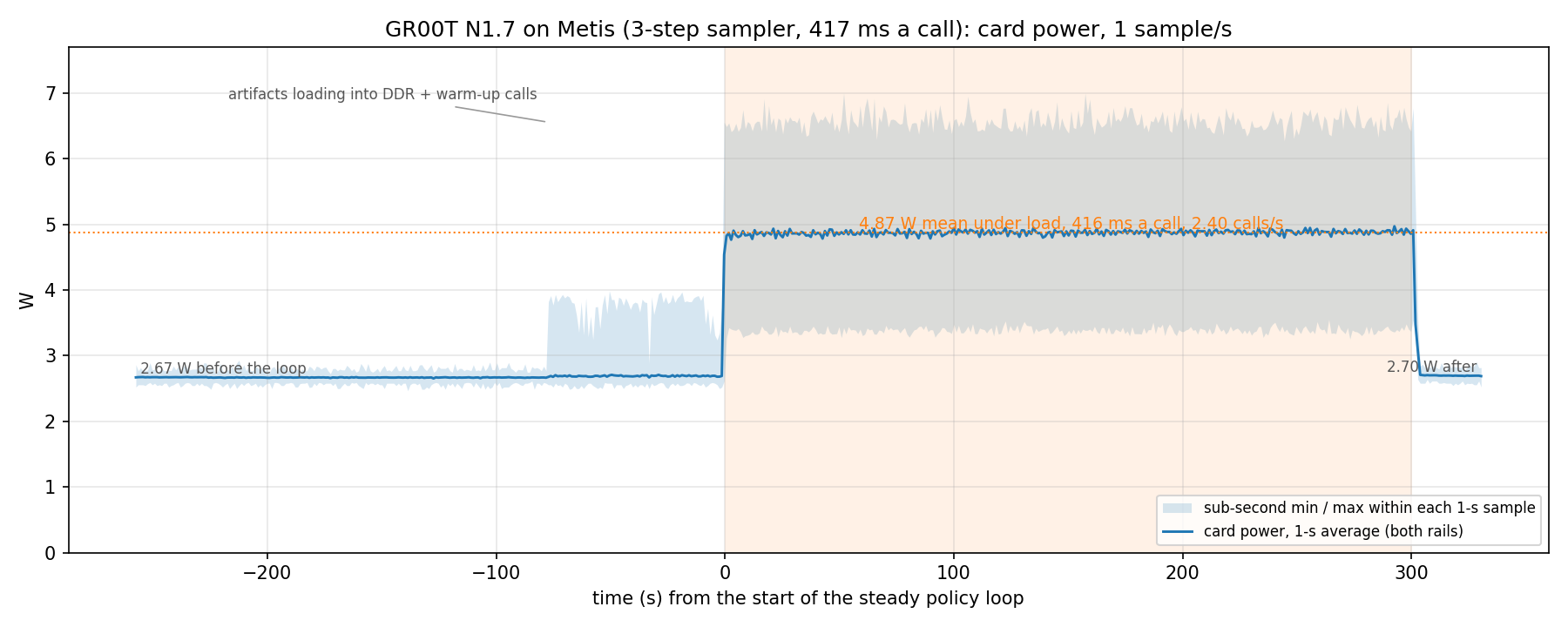

Both Europa and Metis run every transformer in the policy: the vision tower, the language model and the diffusion head. The host runs the simulator plus some light glue logic. On a robot, that means a low-power host CPU is enough to drive the full system. What is the accelerator power?
  • On Metis, I measured power consumption on the Axelera Edge 130p rev2.0 (a PCIe card) which has two embedded power probes (on the main and aux rails) and the power consumption was 4.87W average

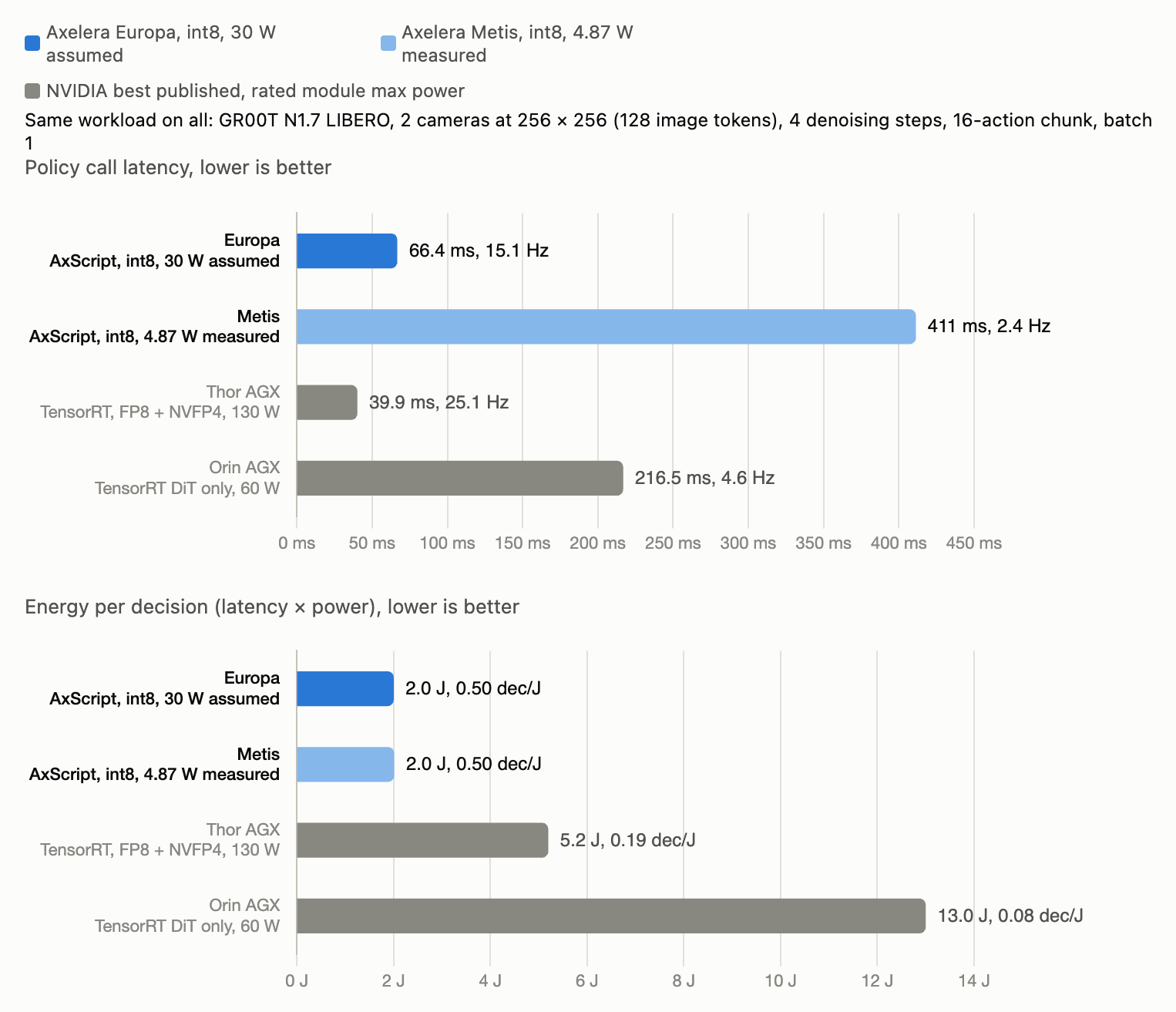

  • On Europa, unfortunately the power probes on the PCIe card are not exposed yet in the SDK, so I could not take measurements. When it becomes available, I will update this post, until then I assume 30W which I expect to be above the actual draw
Compared with NVIDIA's published GR00T N1.7 numbers on Jetson Thor and Orin AGX, both Metis and Europa provide significantly more performance per watt. If we think about thermally and battery-constrained robots, vehicles or other physical AI devices, this can break or make an application. Not to mention that both chips cost a fraction of what GPUs do.
Two bar charts on the same GR00T N1.7 LIBERO workload (2 cameras at 256 x 256, 4 denoising steps, 16-action chunk, batch 1). Policy call latency: Europa 66.4 ms (15.1 Hz), Metis 411 ms (2.4 Hz), Thor AGX 39.9 ms (25.1 Hz), Orin AGX 216.5 ms (4.6 Hz). Energy per decision, lower is better: Europa 2.0 J (30 W assumed), Metis 2.0 J (4.87 W measured), Thor AGX 5.2 J (130 W), Orin AGX 13.0 J (60 W). Axelera Europa, int8, 30 W assumed Axelera Metis, int8, 4.87 W measured NVIDIA best published, rated module max power Same workload on all: GR00T N1.7 LIBERO, 2 cameras at 256 × 256 (128 image tokens), 4 denoising steps, 16-action chunk, batch 1 Policy call latency, lower is better 0 ms 50 ms 100 ms 150 ms 200 ms 250 ms 300 ms 350 ms 400 ms 450 ms Europa AxScript, int8, 30 W assumed Europa: 66.4 ms, 15.1 Hz 66.4 ms, 15.1 Hz Metis AxScript, int8, 4.87 W measured Metis: 411 ms, 2.4 Hz 411 ms, 2.4 Hz Thor AGX TensorRT, FP8 + NVFP4, 130 W Thor AGX: 39.9 ms, 25.1 Hz 39.9 ms, 25.1 Hz Orin AGX TensorRT DiT only, 60 W Orin AGX: 216.5 ms, 4.6 Hz 216.5 ms, 4.6 Hz Energy per decision (latency × power), lower is better 0 J 2 J 4 J 6 J 8 J 10 J 12 J 14 J Europa AxScript, int8, 30 W assumed Europa: 2.0 J, 0.50 dec/J 2.0 J, 0.50 dec/J Metis AxScript, int8, 4.87 W measured Metis: 2.0 J, 0.50 dec/J 2.0 J, 0.50 dec/J Thor AGX TensorRT, FP8 + NVFP4, 130 W Thor AGX: 5.2 J, 0.19 dec/J 5.2 J, 0.19 dec/J Orin AGX TensorRT DiT only, 60 W Orin AGX: 13.0 J, 0.08 dec/J 13.0 J, 0.08 dec/J
